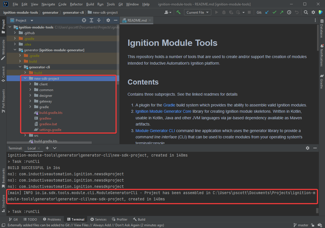

This will create a new project structure for you with seperate directories for each of the Gateway, Designer and Client scopes, as well as a Common and Build directory. If you receive a BUILD SUCCESSFUL
message, you can close the command prompt and open your new project in your preferred IDE:
